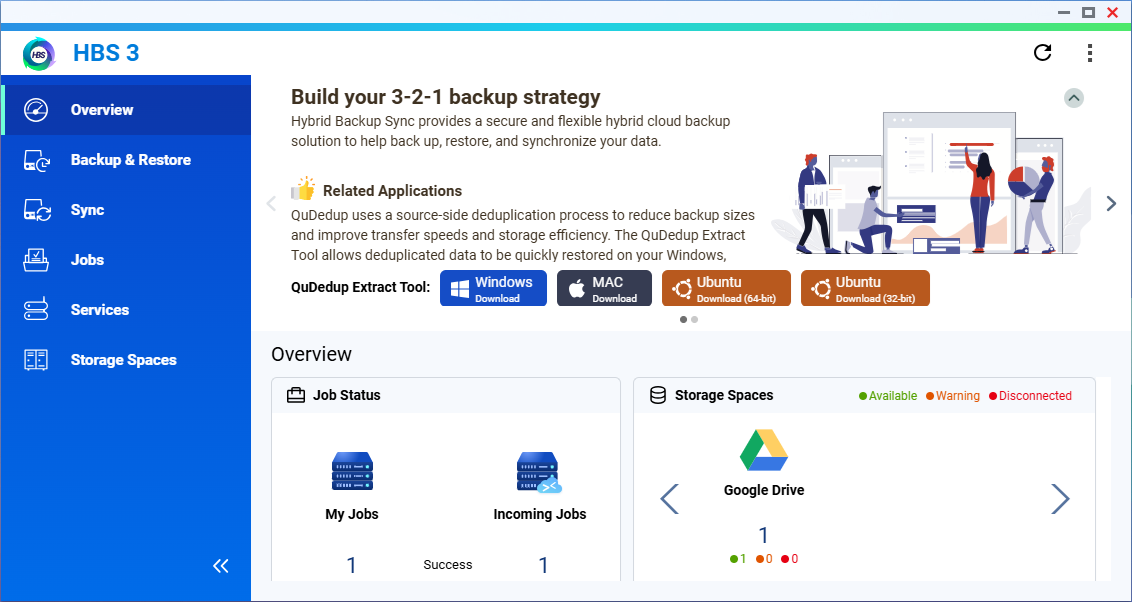

What is HBS?
HBS (Hybrid Backup Sync) is a comprehensive data backup and disaster recovery solution.
HBS supports backing up, restoring, and syncing data between your local QNAP device and a remote device, external device, or cloud storage space. You can also configure USB One Touch Copy for QNAP NAS devices that have a USB One Touch Copy button.

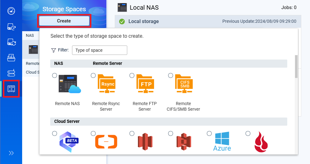

Create a storage space
Creating a storage space in HBS saves the connection and authentication settings of a remote device or cloud storage space.
With saved storage spaces, you can quickly create multiple backup, restore, and sync jobs without having to configure the connection and authentication settings of the storage spaces every time.
  1. Open HBS and go to Storage Spaces.
  2. Click Create.
    A storage space selection window opens.
  3. Select a remote NAS, remote server, or cloud server.
    The Create a Storage Space window opens.
    Note
    For some cloud storage services, an authentication page may first appear in a separate browser window.
  4. Enter all required fields.
    For configuration details, see Storage space creation in the Hybrid Backup Sync Web Help.
  5. Click Create.
